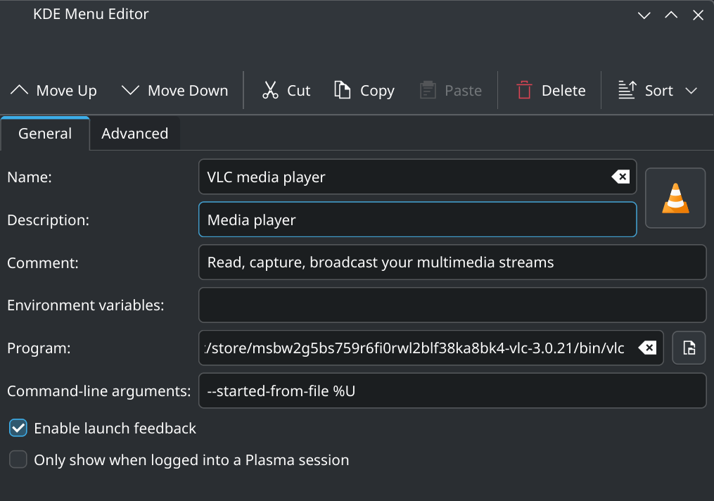

Getting really weird behavior. I was referencing the VLC package straight from nixpkgs but decided to make a wrapper for it to set QT_SCALE_FACTOR. The wrapper works perfectly, but I only get it if run from shell. When launching from Plasma it oens open unscaled, so I looked at the application entry and it’s pointing to a different path.

> lsa $(which vlc)
lrwxrwxrwx 1 root root 55 Dec 31 1969 /run/current-system/sw/bin/vlc -> /nix/store/qm1gh8baz2bxq2zl38ra65ibr7rqixpi-vlc/bin/vlc
