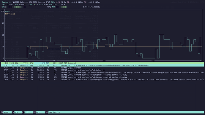

the gpu is being used,
nvtop output with youtube running on zen browser(firefox)
will report again after a reboot
after the reboot it is back to before, nvidia-smi and nvtop reports no use of dgpu. the brightness control is working and the monitor is back to 144hz default. 1 out of like 10 boots is like this, and a hard reset fixes it.

neither have i been able to run brave browser on my dgpu. i tried everything, i tried to mess with chrome:flags too. i tried offload-cmd as well.
