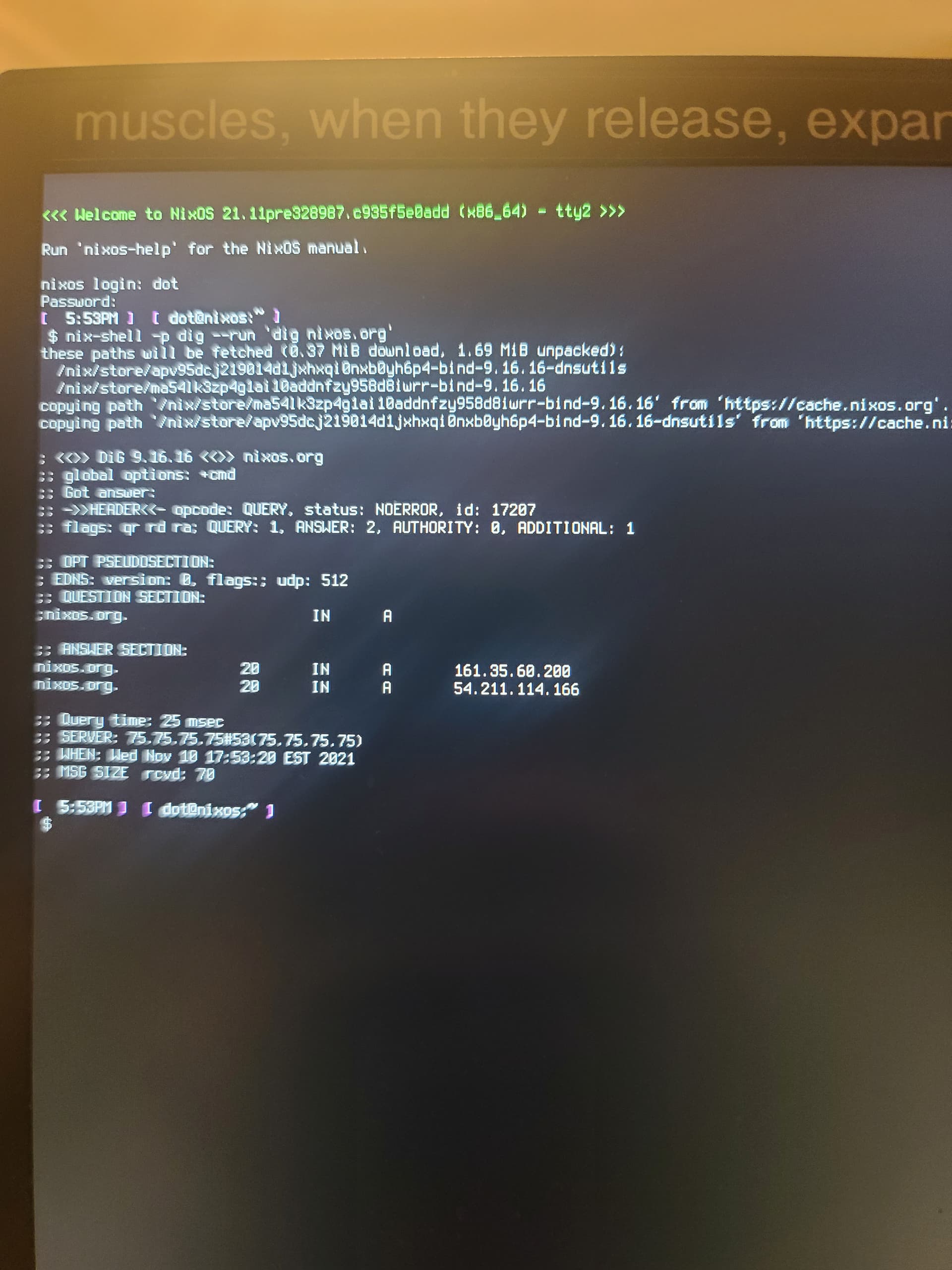

Hmm strange. Originally asked: “could you resolve any host initially?”
nix-shell -p dig --run 'dig nixos.org'
In a tty that returned :
