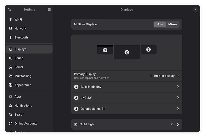

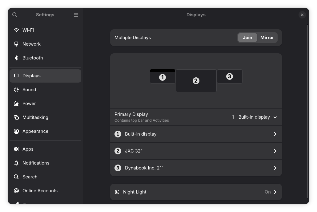

Hello; I use NixOS on a Thinkpad with a USB-C docking station and two external screens. This works fine with 25.11 but going to 26.05, the screens are not detected and don’t work.
Any ideas why? Here is my configuration.nix. Where should I start looking? I don’t know what extra information to give here as I’ve found that saying too much in the OP means that people don’t read it.
Does rolling back to 25.11 make the displays work?
Yes.

When 26.05 is running, the screens are detected and shown in the GNOME displays settings, but they are blank.
I probably should have mentioned this earlier, but it might be useful running journalctl -k and journalctl -b 0 on 26.05 to see if there’s any relevant log entries.
