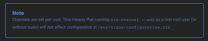

There’s a note about exactly this in the manual BUT I think it’s not in the best place in the manual.
Ah, this one?
I’m still not sure what that note means but only kinda understand what I think it means now that you pointed out my issue
Thanks
Yes that’s the one I was thinking of. I think it needs to go earlier in the section!
