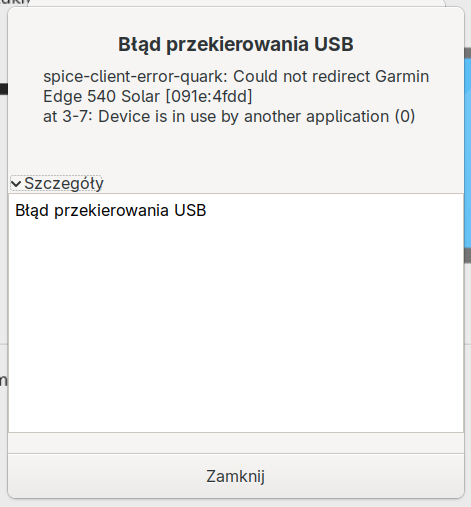

Trying to passtrough USB device to VM I get this error
virtualisation.spiceUSBRedirection.enableis set to true in configuration. What else could I try?
so first of all did you make sure that no other application is using it?
If you still get the error maybe you can find the solution here:
You are right, gnome automount was using the descriptor, pinpointed with fuser. I’ve completely forgotten this great program. Thanks!
