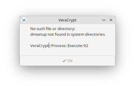

I installed veracrypt but it is running into error when I try to mount a drive.
First it is asking for sudo. So when I launch it as sudo veracrypt it is asking for “dmsetup”:
Looks like the app is not used to the nix way… how do I setup it up so it works?
My nix config:
