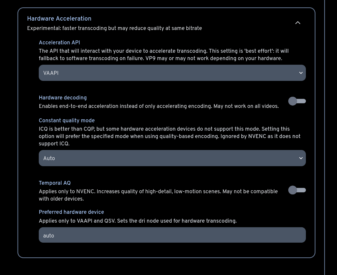

then i change immich options to use hardware accelleration and forces transcoding for all videos.
