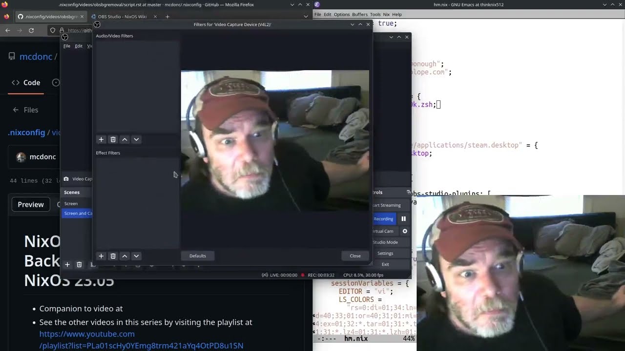

OBS does indeed these days have a proper background blur plugin named obs-backgroundremoval.
WIth that and a virtual webcam via OBS the results aren’t too bad. It does use a heck of a lot of CPU and there is no GPU support under Linux.
Thank you all. I’ll most likely go with OBS since packaging that craziness from Github is too much for my current Nix beginner level.
And @chrism - Thank you so much for the video and the code below. Does it work OKish in a dark room?
programs.obs-studio = {
plugins = with pkgs.obs-studio-plugins; [
I looked at @chrism dot files on Github (thank you so much for that) and I added v4l2loopback boot.extraModulePackages so I can create a virtual camera via OBS.
I also added "v4l2loopback" into boot.kernelModules since my user can’t use sudo and therefore it can’t easily modprobe v4l2loopback.
