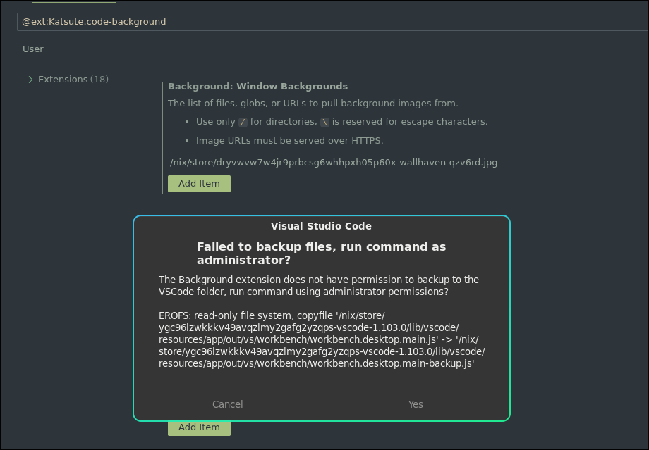

When I try to run the Install Background command from the extension I get the following error:
I believe the cause is that the extension wants to be nice and save the workspace layout before reloading the window (?)
Is there a way to mitigate this behaviour of extensions?

the issue
Alright looks like this this extension cannot work without modifying the source files :frowning:
