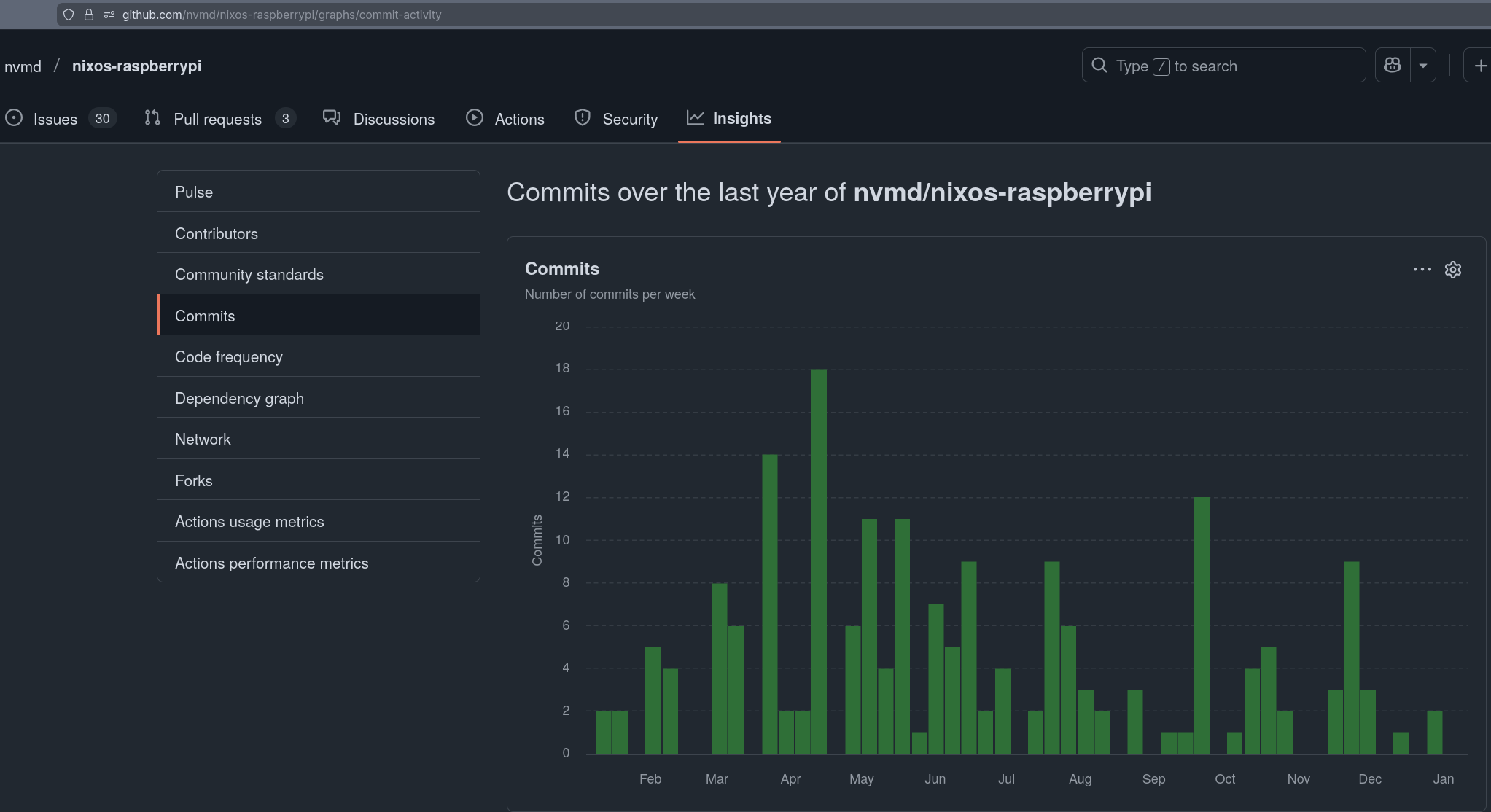

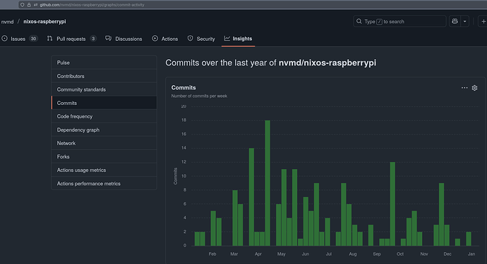

Looking at the GitHub - nvmd/nixos-raspberrypi: Nix flake for a fully declarative NixOS on Raspberry Pi repo, it still looks like it is under active development, because there are recent commits.
Recent commits
( Loving the Gradia screenshot tool :pray: )
So this project looks active, which is great! Does it work for most people? Would love to hear some success stories. I’m not sure if nvmd ( Sergey Kazenyuk ) is on this discourse
If this is the new NixOS solution, that works, and isn’t archived, then I’ll give this a try.
