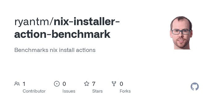

Which GitHub nix installer action is faster?
nix-installer-action-benchmark
I was curious which installer was faster.
Currently benchmarked installers
Results
Based on 1 GitHub actions run.
installer os time
nixbuild ubuntu-latest 2s
nixbuild macos-latest 14s
cachix ubuntu-latest 5s
cachix macos-latest 42s
determinate-systems ubuntu-latest 17s
determinate-systems macos-latest 49s
Questions
  • Is this a fair test?
  • Anything else you’d like me to test?

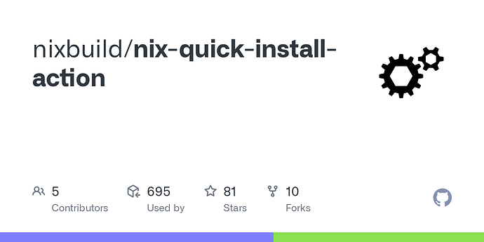

I think nixbuild.net also has a Nix installer GitHub action:
There’s some value in the straightforward test, though idk how many users the detsys installer is adding. I think cachix adds 8? AFAIR user creation is a lot if not most of the time taken up by any install.
Thanks, I updated the main post to include the nixbuild one. Also, the DeterminateSystems one did a lot better on macos this time. I’m not sure if that is variability in the GitHub Actions system or the installer itself. More testing is needed.

  • nixbuild/nix-quick-install-action uses single user installation, that’s why it can be so fast.
