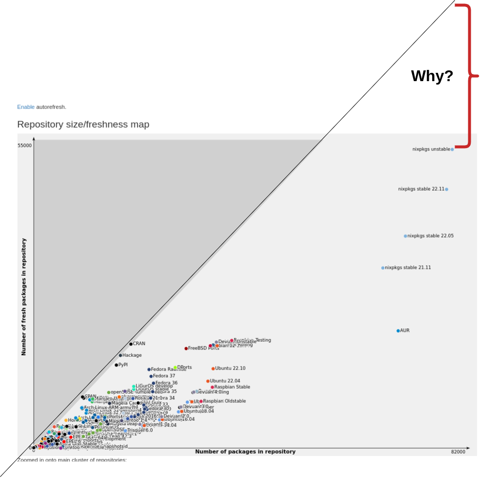

Why is it, that Nixpkgs' freshness isn't closer to its maximum?
Nixpkgs is impressive. But how is that gap accounted for, anyways?
(Graphs - Repology)
I’d be skeptical of any answers that aren’t backed up by an analysis of what’s behind in nixpkgs, and whether the set of laggards is fairly stable or rapidly changing.

Probably because this way of “measuring” freshness assigns equal weight to binutils and left-pad.
The graph charts the number of total packages and fresh packages for each repo. Then the angle from the origin to the point represents the percentage of fresh packages in that repo. Hypothetically, if a repo lies on the line then all its packages are fresh, and if a repo lies on the x axis then none of its packages are fresh.
So the question posed above is: Why are less than 100% of packages in nixpkgs fresh?
There are some other interesting things to note about this chart:
  • Repos that are their own source of truth will always lie on the line, e.g. CRAN, Hackage, CPAN, Ruby Gems, crates.io, etc, because what is a fresh package is defined by it being published in that repo.
  • The absolute number of fresh packages in nixpkgs is still 2-3x most other repos

It looks like repology exposes a week of database dumps at https://dumps.repology.org.
Given that they list when each new version appears in a package’s history tab and when each repo caught up, I assume that the database contains sufficient information to help answer some basic questions…
  • It may not have a sense of what repo is ~canonical, but I imagine it’s possible to cluster packages that always appear first in a given repository
  • get a sense of the typical update interval for every package in unstable
  • ballpark what impact halving the interval of a given bulk update would’ve had on freshness over the last year
  • figure out what was out of date on every day of the year and whether it’s a constantly-churning pot of 2-week update cycles or whether there’s a big core of packages that are almost always out of date
  • maybe try to tease out sets that are out of date because they release extremely often (much effort to keep up) vs those that went 4 years without a release and suddenly sprung to life (anyone who cares may no longer be watching carefully for updates)?
