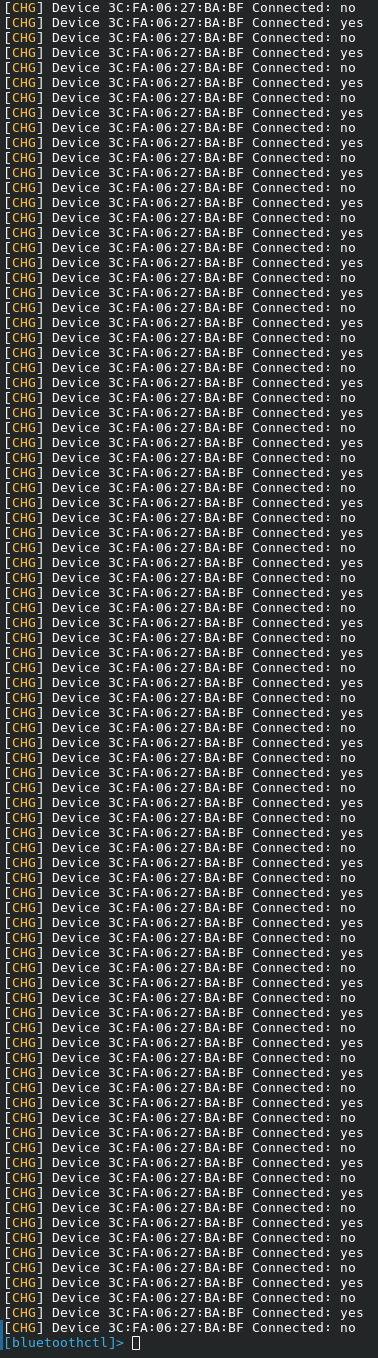

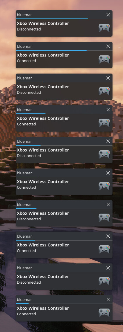

I am trying to connect my Bluetooth Xbox controller to my PC running NixOS 25.05, but whenever I try to connect it after a successful pairing, it does this:
I am running KDE Plasma 6 on the following hardware:
Ryzen 5 7600
AMD RX 9070 16GB
32GB (2x16) DDR5 6000MHZ CL30
Asrock X670E Steel Legend
so far I’ve tried to add:
hardware.xpadneo.enable = true;
to my config, but that did nothing.
Any ideas?

What is your controller , did your try remove <mac> and pairing it freshly and did you rebulild after hardware.xpadneo.enable = true; then see these

Aaaaaand BINGO!
We’ve got a solid indicator light!
We’ve got input!
We’ve got no weird disconnect loops!
and all it took was adding:
hardware.bluetooth = {
enable = true; # enables support for Bluetooth
powerOnBoot = true; # powers up the default Bluetooth controller on boot
settings = {
General = {
Privacy = "device";
JustWorksRepairing = "always";
Class = "0x000100";
FastConnectable = "true";
to my config!
