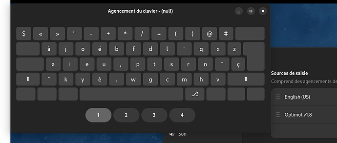

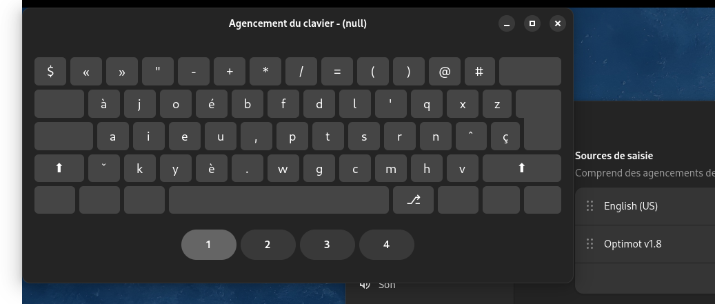

Inside Gnome when you look at keyboard preview it’s like that.
