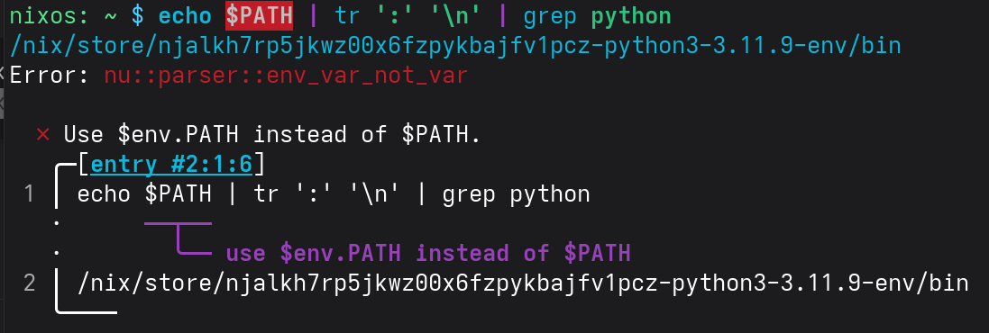

Works for me, what’s your path?
[nix-shell:~/src/mine/experiment]$ echo $PATH | tr ':' '\n' | grep python
/nix/store/njalkh7rp5jkwz00x6fzpykbajfv1pcz-python3-3.11.9-env/bin
due to
ok, well I guess translate that expression to something nu understands :slight_smile:
or ditch nu when it starts getting too complicated :smirk:
well by my 3 second investigation, $env.PATH should be sufficient to pretty print the path. What do you get if you run that inside the shell?

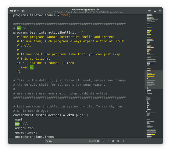

{ config, pkgs, ... }:
  boot.initrd.kernelModules = [ "amdgpu" ];
  hardware.graphics = {
    enable32Bit = true;

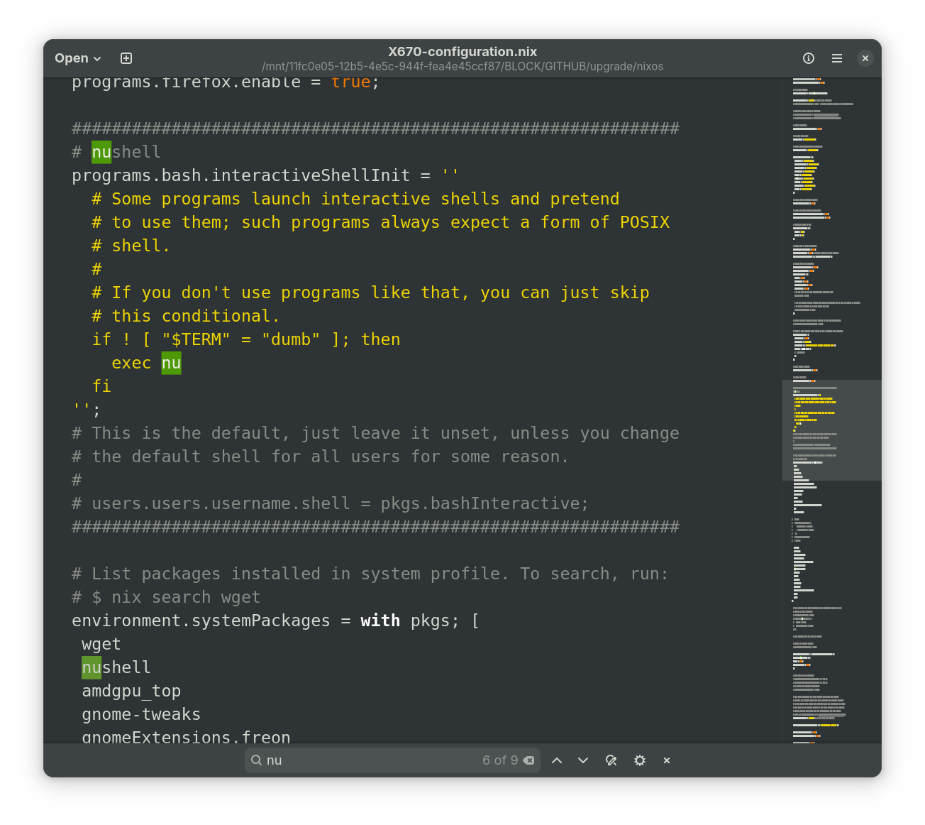

  # nushell
  programs.bash.interactiveShellInit = ''
    # Some programs launch interactive shells and pretend
    # to use them; such programs always expect a form of POSIX
    # shell.
    # If you don't use programs like that, you can just skip
    # this conditional.
    if ! [ "$TERM" = "dumb" ]; then
      exec nu
    fi
  # This is the default, just leave it unset, unless you change
  # the default shell for all users for some reason.
  # users.users.username.shell = pkgs.bashInteractive;

do not exist.
Which is my best bet to proceed, if there is no chance to reproduce the issue? Thanks.
Have you attempted this? I still suspect that nu starts and immediately exits for some reason, likely not being able to read a configuration file or such.
Yes, I did but no effect.
I can type exit and it falls back. I suspect, something happens to the PATH.
It has turned out that unfortunately my implementation of the recommended setup, see Nushell as default shell, has not worked. Rather successfully, just run nushell by typing nu from the command prompt and you are good to run python.
