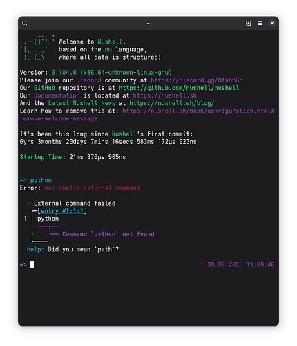

Nushell - NixOS Wiki is pretty good. I would like to set nushell as default shell but hesitate due to - see screenshot.

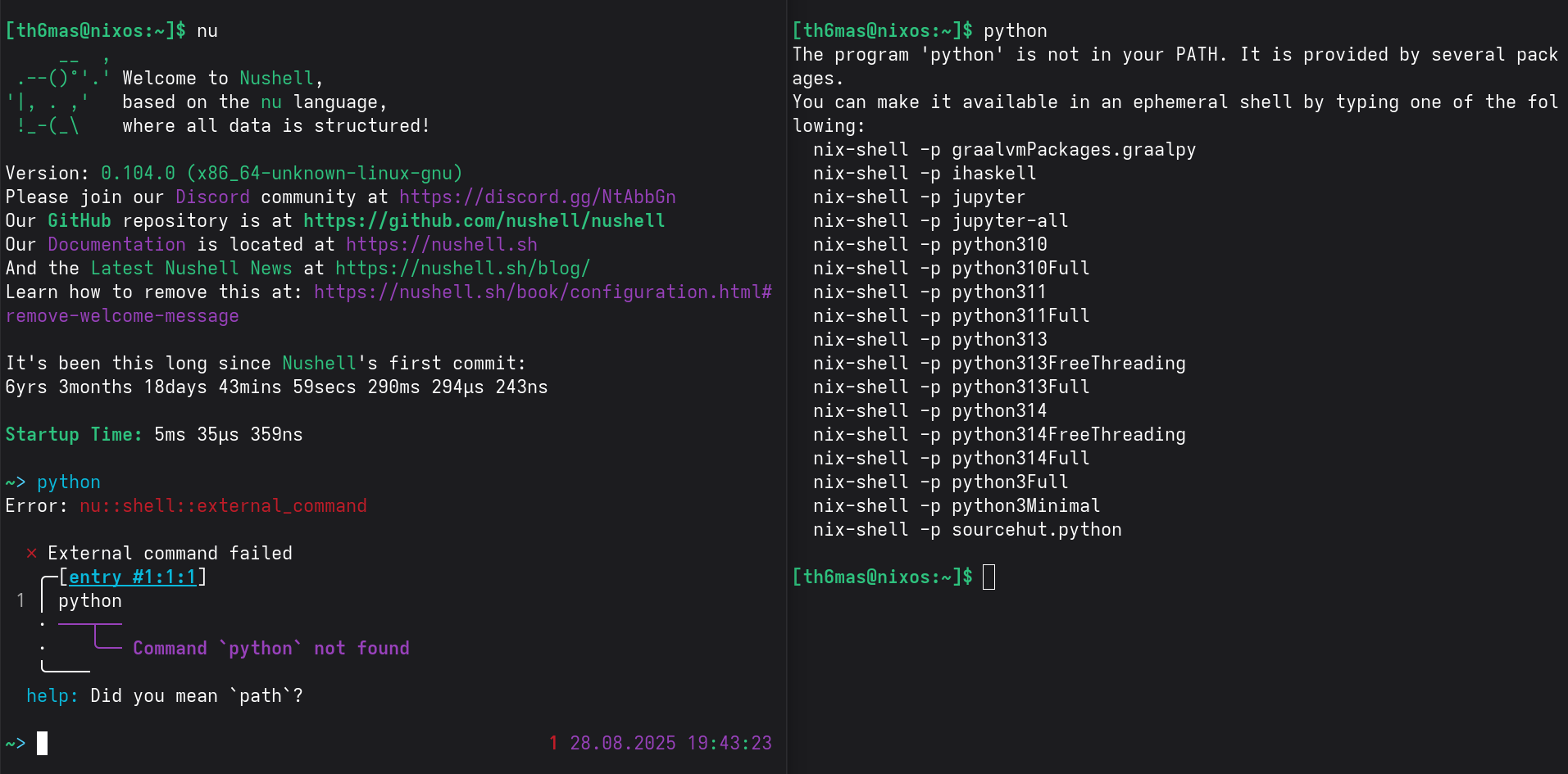

Thanks. I tested the POSIX approach, see screenshot. The above snippet works. A caveat seems lacking to show any options when calling python which is deliberately not installed. I did remove
$env.PATH ++= [ "~/.nix-profile/bin" ]
from env.nu - right or wrong?
It should be clarified, the behavior in the screenshot in OP is not vanilla bash behavior. The display where it provides suggestions for what packages the user may want to use is provided by a modules configuration in nixpkgs
As you can see if you follow the link, the only supported shells for that are currently: Bash, ZSH, and Fish. You are welcome to check to see if support for Nushell has been requested, or request it yourself, or maybe if you wanna be really cool, add the configuration yourself!!!
