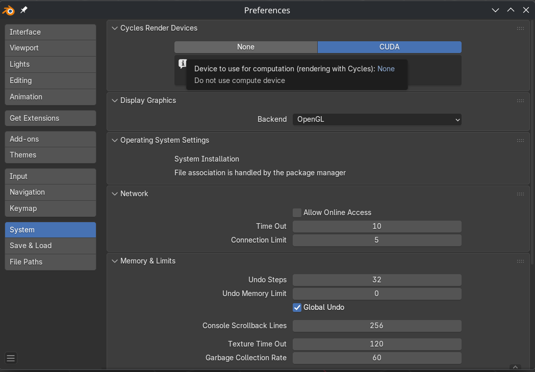

i see this only when running on terminal
❯ blender
00:06.172  cycles           | WARNING CUEW initialization failed: Error opening the library
00:13.153  blend            | Saved session recovery to "/tmp/quit.blend"
00:13.154  blend            | Writing user preferences: "/home/phatle/.config/blender/5.0/config/userpref.blend"
00:13.154  reports          | Preferences saved

thank you this might do the trick now. atleast compiling alot and long time first so that is promissing
thank you so much to point my mistakes and fix configuration files this fixed the issue on cuda with blender and i moved steam to configuration.nix too since on home.nix it still wants that allowUnfree = true to be set. i am learning alot and next steps is to make files better, modularity and system faster etc
