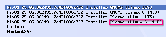

Okay, that’s good to know. I’m just going through a virtual machine install right at the moment. How do I have it install unstable? Is it on boot where I select the Kernal? Sorry if it’s obvious I went through the process all the way and didn’t see where it gave the option. What am I missing?
nixos-install has a --channel parameter, I think a value like nixos-25.05 or nixos-unstable would work (depending on whether you want stable or unstable).
Okay, I was using the graphical installer but I’m I’ll try the command line and the minimal ISO at some point. Thanks for the information.
The graphical installer will copy the channels from the installation image, so if you are using the unstable ISO you will get the unstable channel (you will have to nix-channel --update after installing, as the channel may be outdated by the time the system finishes installing).
