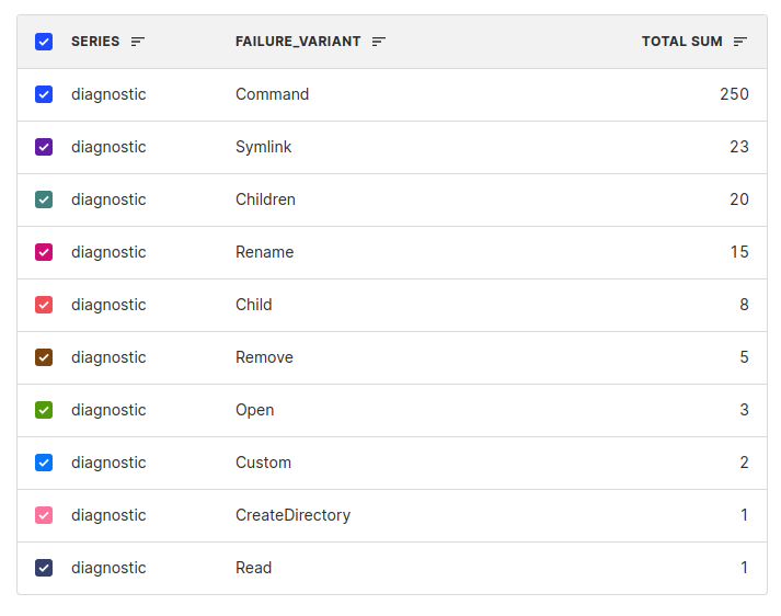

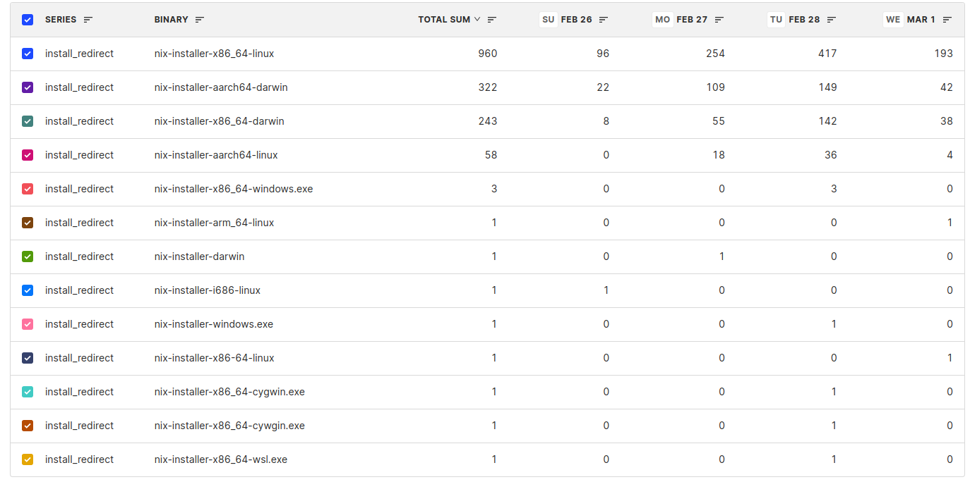

Here are the notes from the meeting today, 2023-03-1!
Notes

        • A peculiarity of the DNI is that it sends automated reports on installation failures. That probably wouldn’t work for upstream, and cause the DetSys version to be aware of some problems earlier
